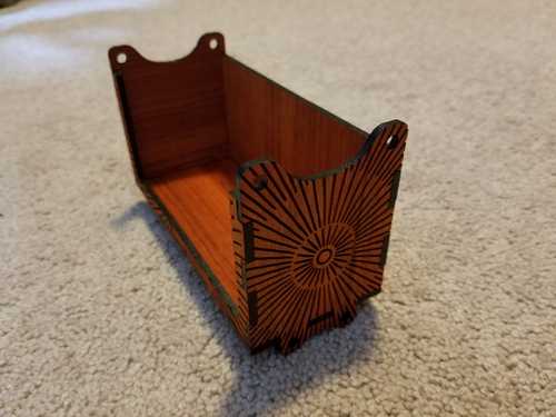

Ok, so here’s my first try… Testing the design, joints, kerf, etc.
As a thin piece, the long horizontal part of the front was weak and snapped in multiple places when I was press fitting it together, as you can see below… maybe a bit too tight on the finger joints for the amount of pressure needed for me to snap them in.
But, other than that, the design was solid, joints were tight, and I liked the dimensions all in all.
The pieces are sized and nested/arranged to be cut from one piece of 6"x12" hardwood, in order to be efficient with material, (be created from one sheet of
hardwood.
Also the 2 sides are cut so the wood grain is the same on each side for continuity in appearance. It’s tight, but it fits… barely.
So, I polished off the design (created in Illustrator as vector cut pattern with an embedded engraved image saved as an .svg) with rounded corners, added curves to the design, and a pattern texture to be engraved. I think it turned out great!
This is pre-finished still with no sealant applied to the inside.

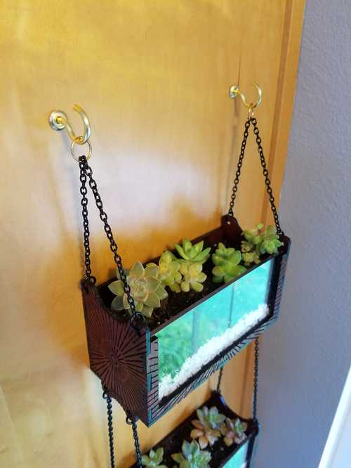

Cut 3 pieces of clear acrylic for the front panels, added a bit of wood glue in a few spots at the joints where there was slight warpage, then painted on the rubber/silicone sealant, slid in the perfect fit acrylic, and let them dry overnight
Went out and bought some black jewelry chain, black jump rings, some screw in hooks, and used 2 raw brass jump rings at the top. Put it all together (carefully), and here it is.
I then tested it all hanging in the kitchen where I wanted to hang it.

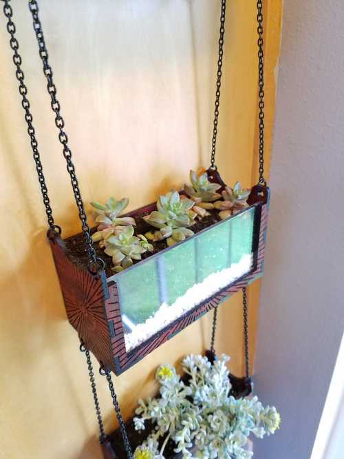

And finally, here are a bunch of shots of them planted and finished!
Some shots during the day, but hard to avoid the reflections on the front pane…
I just love that this one is in bloom while planting it. It’s really beautiful.
And here’s some more pics at night (minimal reflections from outside).
