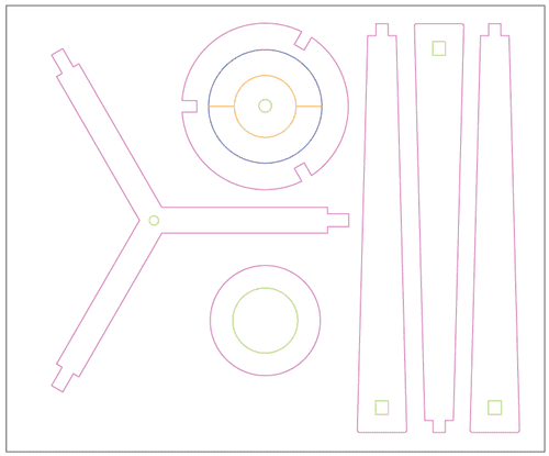

Here is the (deceptively simple) drawing from Illustrator I started with and pictures of a few early versions. The three pointed piece near the bottom started as an jig to space the legs apart while gluing them, and morphed into an integral part of the structure.

After making this first version, I realized several things. First and most importantly I needed to come up with a way to use the glowforge to fixture the rings for drilling. Each ring has little holes through it with a wire connecting it to the next smaller ring. They need to be very precisely positioned and straight or else the rings won’t move very well. Without a jig I was unable to get the long thin drill bit to stay accurate as it moved through the wood.
I also did not like the proportions of the tripod, the legs looked to “designerly” when they were tapered, and I wanted to figure out how to lock the pieces together without gluing them. That last part became a rabbit hole of indeterminate depth as I fell into a world of Japanese joinery full of pins and wedges and slits and notches. The solution I ended up using is a simple one, but I have lots and lots of other things I want to try.
Here is a detail shot of the way I cut a little wedge and pushed it into a slot to keep the legs together.
I tried making semi-circular jigs to hold the top rings for drilling on my little drill press, but that still did not give me the precision I wanted.
In the end I decided to make two piece rings and sandwich the pivots between two layers. This time precision was built into it by making the cuts on the Glowforge, and I went an extra step by cutting little sections of brass tubing (not on the Glowforge) to make hinges. So here is the bottom layer:
And here it is with the top layer screwed on. I would very much like you all to see those perfect LASER CUT COUNTERSINKS. Yes indeed, all the same depth, and a perfect fit on the screw heads. I suppose if you have not tried to do this by hand you may not understand why it is so exciting. If you haven’t, then just take my word for it, it rocks.

The “final” drawing and a quick video of it in “action”.
